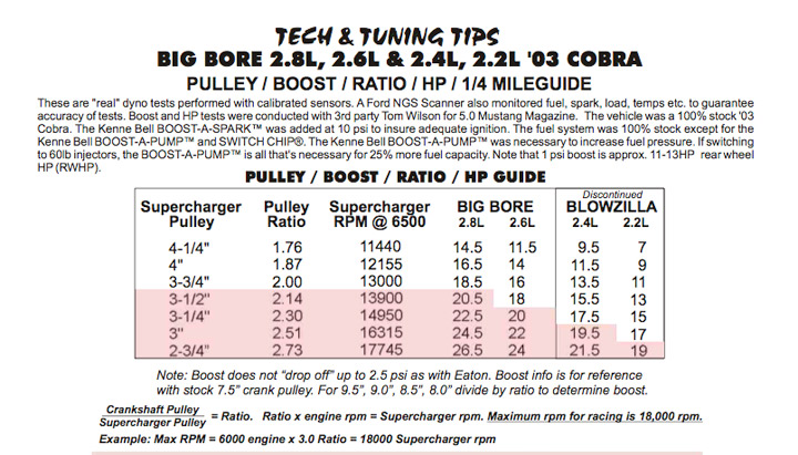

easiest way to figure how close your blower is to maxed out is with math.
what is the crank pulley size?
what is the blower pulley size?
visit the KB site with that info to see where the blower is spinning at.

17 degrees would be conservative timing for TWENTY pouns of boost I run 19 degrees with 19 psi and pump gas.
with 14 psi i would exspect aroun 24 degrees timing on pump and more with torco.
so again that doesn't add up areyou sure is not at 19 psi ? that would make perfect sense

Man that stung! I'm running a 3.5 upper, 6# lower Billetflow idlers, reichard upper idler and lfp alternator.
3.5 upper + 6lb lower = 19-20 psi. It's the exact setup I'm running. I also have fully ported heads, cams and longtubes with a 2.6KB. Something is up with your gauge/boost line if you're only seeing 14.
It's SCT tuned right? You can datalog the car yourself and see what your timing is.
I'm was not trying to start crap...just pointing out that your numbers didn't add up.
Here's the boost guide on KB's website. A 3.5" upper on a 2.6 is supposed to make 18psi. On a stock car, the upper/lower combo should make around 24psi. You and I both see less because of the port work and longtubes.
