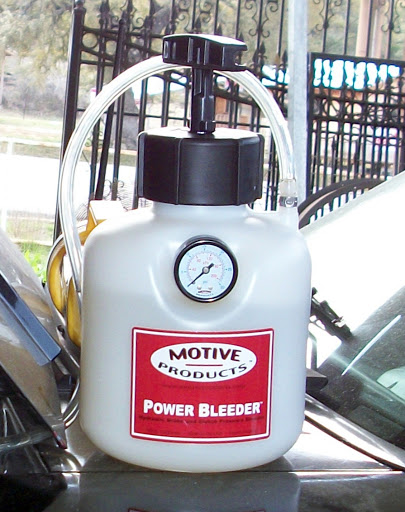

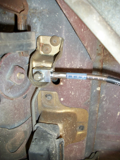

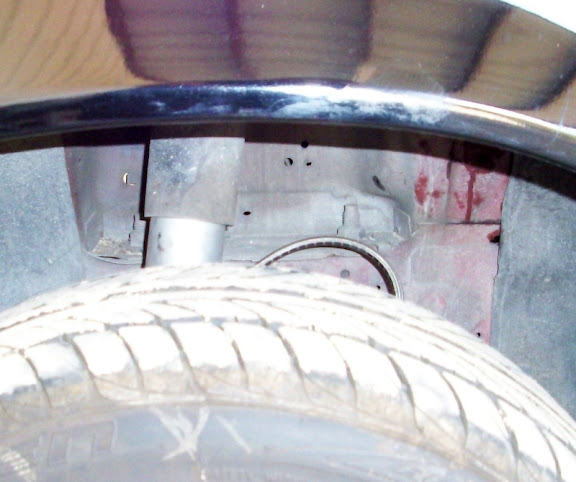

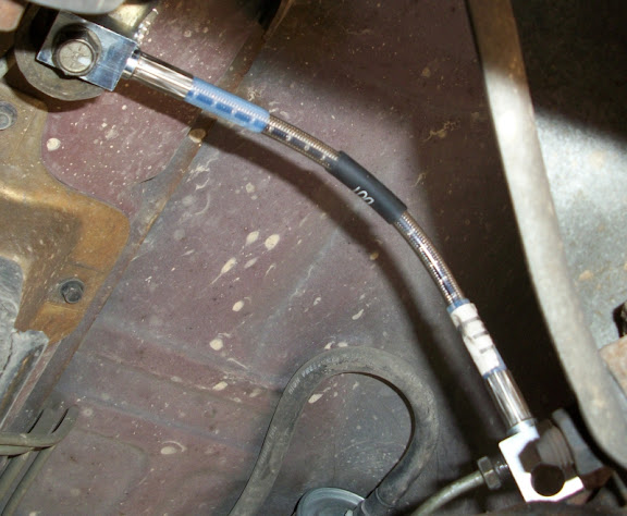

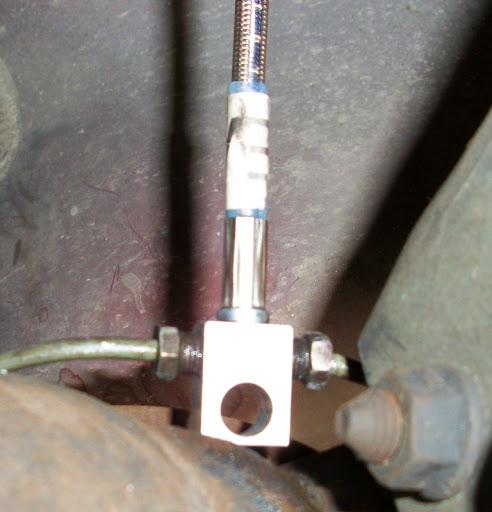

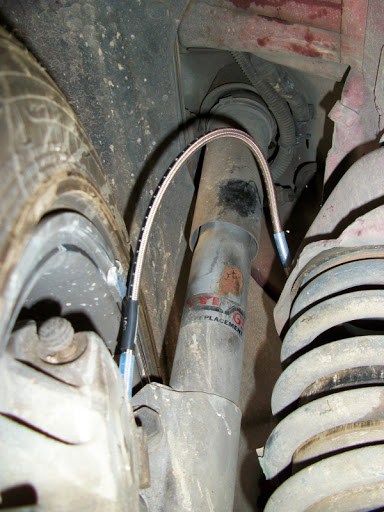

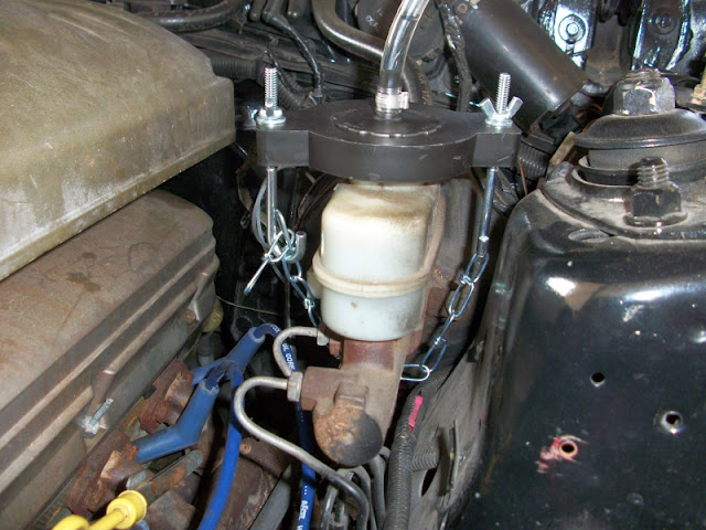

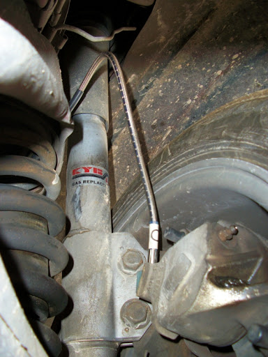

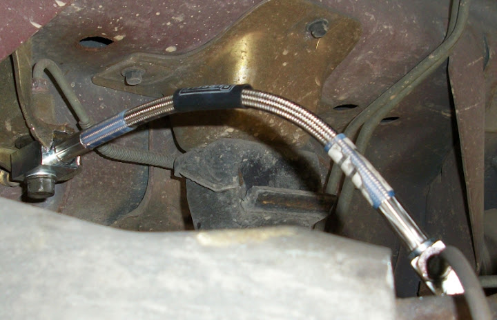

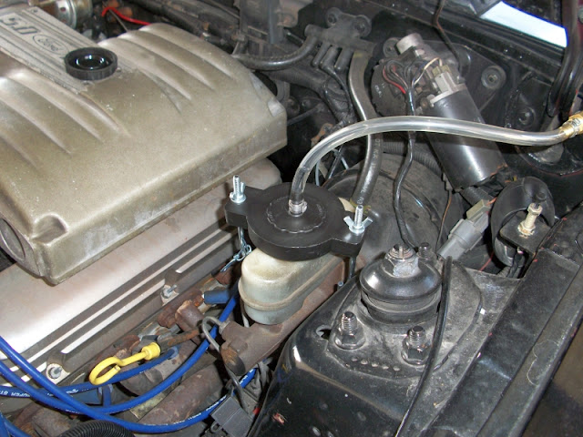

    Ordered Russell Street Legal Brake Line Kit from summit last week. it was pretty simple with some modifications to the existing brackets. i had also ordered Motive Product Power Bleeder Kit #MVP-0101 which i recommend to everybody it really well. i didnt get test out the car since it got late.

    Looks like Motiva has changed their design on how the power bleeder attaches to the MC reservoir...I like it a lot better. Mine screws on like the factory cap and it can be a real pain.

    I wasnt a big fan of the russell brake lines. I didnt like how things had to be modified to make them fot correctly. I wouldnt recommend them thats for sure but you live you learn i guess.

    I want to say that the Maximum Motorsports lines do not require any modifications if going on the application they are ordered for. If you are installing the SN95 brakes on a Fox they have kits for that as well. This is not cheap but I usually don't go cheap on the brakes.
